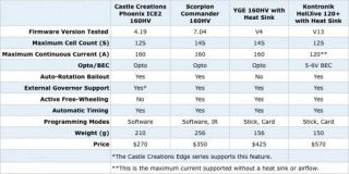

Alright, let’s look at what ESC’s I’ll be reviewing and check out what categories I’ll be considering…

Review_Shootout2_327x695

Review_Shootout3_400x300

Review_Shootout4_397x398

Review_Shootout5_609x415

Ok, so that’s it. What does it all mean? Well, before I unveil the final scores, I want to remind everyone that these are all my opinions and I’m quite certain that they’re not shared by everyone who’s flown these ESC’s, but that’s what’s nice about this kind of review, right? Again, to get my final scores, I took the score for each ESC in each category and added them up. Lowest score wins…
I guess it’s not surprising that the Kontronik won, but I was surprised to see that the YGE came in tied for last with the Castle. In fairness to the YGE though, the lack of bailout isn’t the same “bad” score as last place for governor performance. If you got rid of the bailout as a factor in your decision-making process though, you’d get the YGE tied with the Scorpion and just behind the Kontronik with the Castle bringing up the rear.
