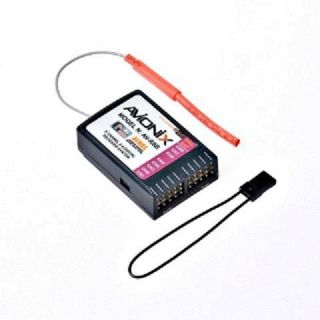

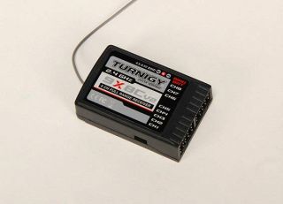

CAMELIONНад последним верхнем разьёме написано BIND (не верь ),так вот туда не надо ,а нужно вставлять где написано BATT“battery terminal” ,то есть чуть ниже .
“bind” does not work! Instead, plug the binding plug into the “battery terminal” on the receiver, and plug the battery or BEC into any other channel. A light should start flashing inside the receiver. This is signal that the receiver is ready to bind. Turn on transmitter while holding in the bind button on the module in the back. The light should stay on now. Reset all power.
